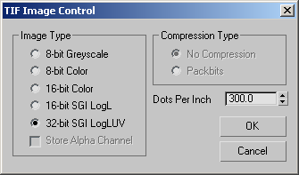

Interface
To open the TIF Image Control dialog, click Save or Setup on the
Render Output File dialog.
Image Type group
Lets you choose the method for saving image information:
8-bit Greyscale Creates an 8-bit grayscale image.
8-bit Color Creates an 8-bit color image.
16-bit Color Creates a 16-bit color image.
16-bit SGI LogL Creates a color image that includes a logarithmic encoding of the luminance channel.
32-bit SGI LogLUV Creates a color image that includes a logarithmic encoding of the luminance channel and UV color coordinate information.
- Store Alpha Channel
- When on, stores the alpha channel along with other image data. Alpha data adds 8 bits per pixel to the image type you selected.
Compression Type group
Lets you render a compressed TIFF file. Default=No Compression.
No Compression Does not compress the rendered image.
Packbits Uses the TIFF Packbits algorithm to compress the file.
- Dots Per Inch
- Sets the dots per inch (dpi) for the saved image. This setting does not change the resolution of the final image, but can affect the way it prints in documents.
