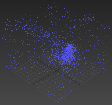

    A CFDImportObject is created with vertices at the positions in the CSV file. By default, it is at the world origin. Transforming it has no visible effect, but you should not do it anyway because it will make it difficult to align the objects used for visualization.

  4. Select the CFDKeepNVertices modifier and set the number of points to keep. CFD simulations typically contain more data than is needed for basic visualizations, and reducing the number of points can speed up the computations.
  5. If desired, you can further speed up later steps in the visualization process by converting the object to an editable mesh or poly, for example by right-clicking on it the viewport and selecting the corresponding item from the Convert To: menu. This "freezes" the object and prevents it from updating and rereading the CSV file.
    If you want to keep the "live" object in the scene, then clone a copy of it and convert the copy instead.
  6. If desired, you can hide the object so that its vertices do not occlude the objects that you will add for visualization.
