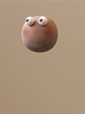

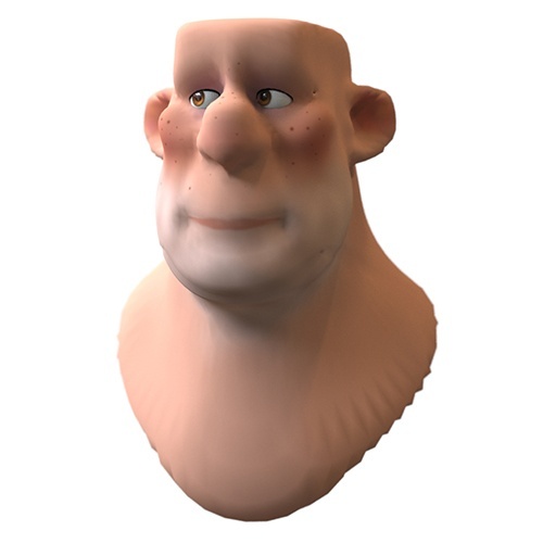

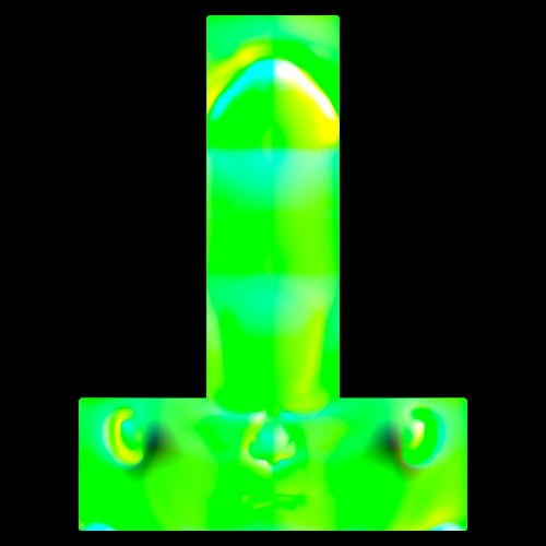

| sphere without vector displacement | vector displacement map | sphere with vector displacement |

Make sure that you use a 32bit or 16bit floating-point format to store your image, and not an integer format. An integer format will not work correctly. This is because integer formats do not support negative pixel values, which are used by floating-point displacement maps.

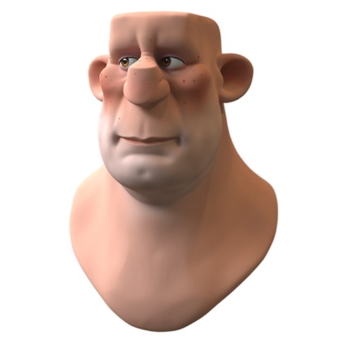

You can see a subtle difference in quality between 4 and 6 subdivision iterations in the images below.
| 2 | 4 | 6 |

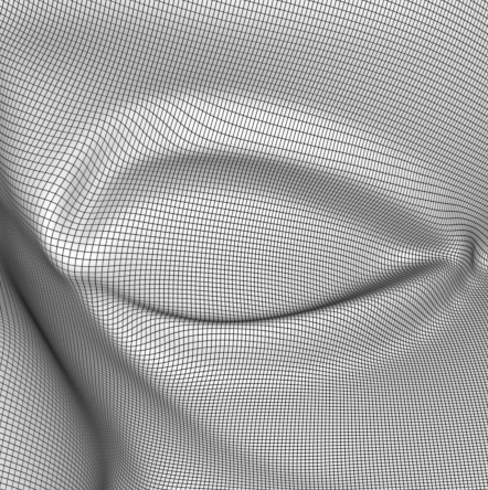

The utility shader can be useful for diagnosing issues when rendering displacement maps.
Utility shader. Shade_mode set to ndoteye and overlay_mode set to polywire.
