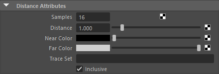

The distance shader uses sample rays to estimate the distance from the shading point to the nearest surface. This distance is mapped to a color linear gradient from near_color to far_color. You can use trace sets to include or exclude objects from the distance measurement.
