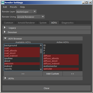

This is what we see when we look at the list of AOVs. We can see all of the above components in the AOV list, however, there are more AOVs other than what is in the standard_surface shader.
| List of AOVs |
We can see some components are broken down into four AOVs, for example with coat, there are coat_albedo, coat_direct, and coat_indirect. In addition, there are also a couple of direct and indirect AOVs and there are no base AOVs, however, there are diffuse AOVs. The standard_surface simulates a physically-based shader and so the diffuse parameters are named base. Then we have diffuse, specular, sss, coat, sheen as well as other AOVs. These AOVs can be used to build the final image in a compositing software package. The AOV with the _albedo index is the pure color of our component. The texture (flat color) is given to the color parameter of the shader.
