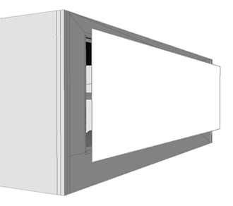

Plane outside window with emission_scale set to 1

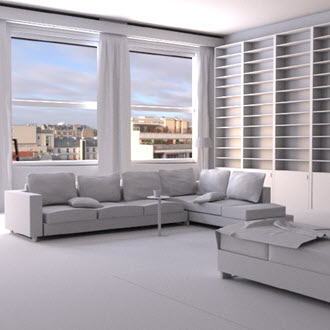

Adding an HDRI map to the emission_color of the Standard Surface shader is another option to light the scene. In the images below an HDRI of a view through a window has been used.
HDRI assigned to Emission Color of Standard assigned to plane outside window | HDRI in window appears blown out |

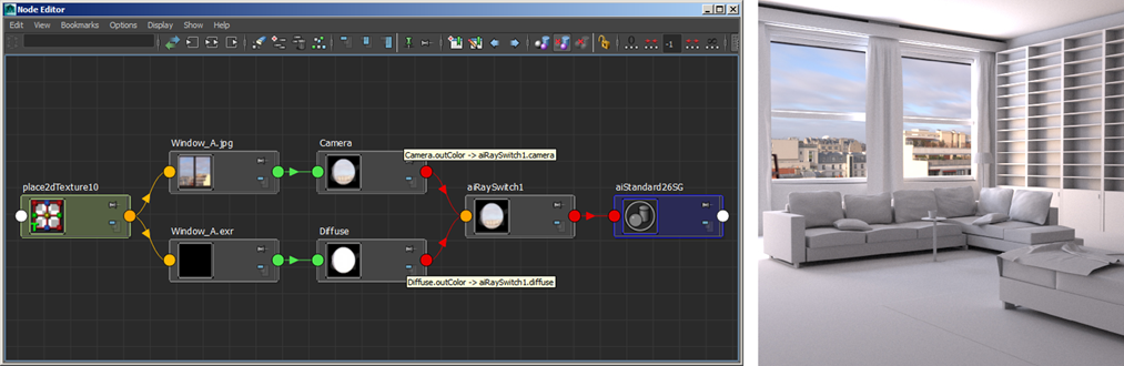

The window HDRI appears blown out when assigned to the emissive plane. A way around this is to use the Rayswitch shader. A Standard Surface shader with the HDRI image is used to control *Diffuse GI rays* and another Standard Surface that contains the same image as a JPEG is used for the camera rays.
Rayswitch shader assigned to emissive plane geometry. The window JPEG texture is visible to camera rays, while the HDRI is visible in diffuse rays
The window HDRI appears blown out when assigned to the emissive plane. A way around this is to use the Ai Rayswitch shader. An Ai Standard Surface shader with the HDRI image is used to control *Diffuse GI rays* and another Ai Standard Surface that contains the same image as a JPEG is used for the camera rays.
Rayswitch shader assigned to emissive plane geometry. The window JPEG texture is visible to camera rays, whilst the HDRI is visible in diffuse rays
