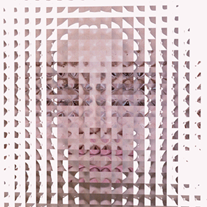

amplitude of cell_noise shader keyframed

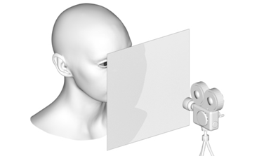

Cell_noise is a very versatile shader that can be used to reproduce a wide variety of shading effects. In this short and simple tutorial, we will show possible uses for it to produce an abstract 'collage' style graphic effect. We will connect the cell_noise shader to the displacement attribute of a transparent object in front of the camera to distort the subject matter behind it (in this case a head). We will use the various attributes of the cell_noise shader to reproduce some of the example images below (all of which can be animated).

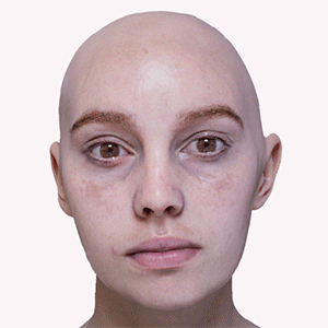

The digital Emily model can be downloaded here.

base_weight: 0
specular_weight: 0
transmission_weight: 1

Below are renders using the various noise patterns of the cell_noise shader.
| Noise1 (default) | Worley1 | Alligator |
Changing the randomness value can have a big effect on the result.
| 0 | 0.5 | 1 |
Once you have mastered this effect, why not try applying it to different scenes to see what you can achieve. You could also try adding other shaders to alter the effect of the cell_noise shader such as utility, ramps, and color_correct. Below are some further examples using these techniques.
