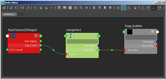

This tutorial shows how to shade the swirling rainbow color effect on a soap bubble. It can be achieved using a fluidTexture2DShape. This scene file consists of a fluidTexture2DShape that is connected to standard_surface.specular_color.
The scene can be downloaded here.
fluidTexture2DShape -> specular_color
Note:
You must play through the animation time slider in order to see the fluidTexture2D effect.
