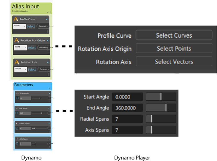

  1. Turn on Is Input
Ensure that all the script input nodes you want to control in Dynamo Player are configured with the Is Input flag turned on. This includes Select from Alias, Number Slider, Integer Slider, and File Path nodes. Otherwise they cannot be read or displayed by the Dynamo Player.

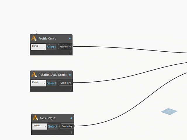

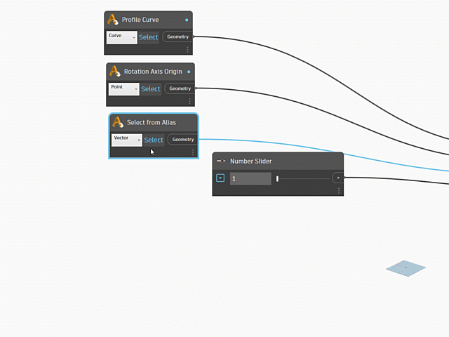

  1. Rename nodes
Provide useful names of the nodes you expose in Dynamo Player. This makes it easier for the script user to identify the nodes and how they function in the script.
  1. Do either of the following:
    • Right-click the node and select Rename Node.
    • Double-click the node name.
  2. Type a name in the Edit Node Name window.
Tip: In Dynamo, you can hover over a node to see its default name.
  1. Create groups to organize input nodes
Grouping your input nodes in Dynamo lets you organize how they display in the Script Input section of Dynamo Player. Ungrouped nodes always appear at the top of the Script Inputs section no matter where they appear in the script.

  1. Organize input nodes from top to bottom
Input nodes display in Dynamo Player in the order they appear in Dynamo starting from the top to bottom. Typically, the Select From Alias nodes should appear at to the top of the script followed by other inputs such as Number Sliders and File Path inputs.

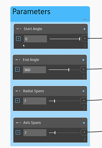

  1. Set minimum and maximum value ranges for slider controls
You can set minimum and maximum values for the numeric parameters you expose to Dynamo Player. To do this, expand the slider node and set the desired value ranges. The parameter values that are set when the script is saved in Dynamo, appear as the parameter's default values in Dynamo Player.

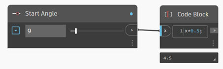

Dynamo Player does not support the step parameter of Number Slider and Integer Slider nodes. As a workaround, you can place a Code Block node after the slider node to generate the step value before the value gets passed to the next node in the script. For example, if you want to step the slider value by 0.5, create a Code Block node and add this simple function: x*0.5;
