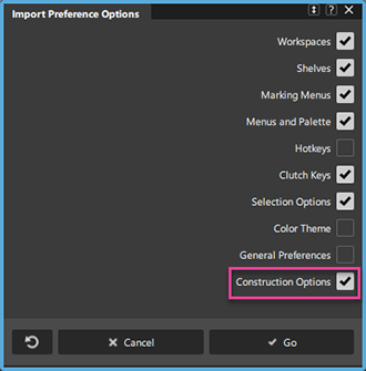

Construction Presets from previous versions of Alias can be added to Alias 2024 when you import your Preference Sets (.aps files). When importing ensure that Construction Options is on in the Import Preference Options.
See Workflow - Importing Preferences from a previous version.

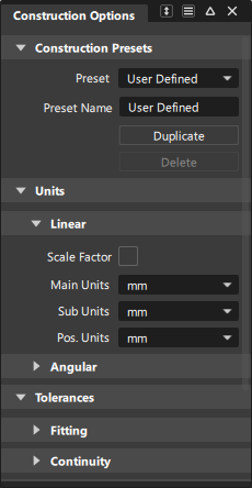

Create a set of custom tolerances
  1. Open the Construction Presets section of the Construction Options window.
  2. Choose one of the settings profiles from the list:
    • If the settings you want to add are very similar to one of the preset CAD packages, click the name of the CAD package.
    • Otherwise, click User Defined.
  3. Click Copy.
  4. Double click the new profile to rename it.

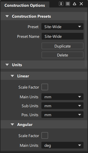

Access site-wide construction presets on a network
For information on setting up site-wide Construction Presets in Alias 2023 or earlier, see Set up site-wide construction presets.
If your administrator has placed the construction presets file from Alias 2023 or earlier in a shared network location, follow these steps to access it:
  1. Set environment variable ALIAS_CONSTR_PRESETS_LOCATION to the network location (path) where the site-wide construction presets file is located.
  2. Start Alias.
    The construction option settings default to those in the construction presets file on the network. These construction presets cannot be edited
If the administrator changes the construction presets file on the network, each user must re-start Alias to see the changes in the Check Model and Construction Options windows.
