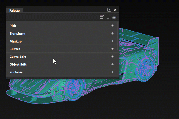

Access the Markup brushes from the Markup tool palette:
When using a Markup brush, if no markup is currently active, it creates one on the current view. Rotate the view to exit the active Markup when you are finished drawing. Markups are automatically saved and can be accessed in the Markup Lister.
