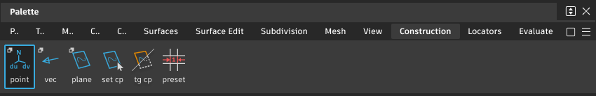

Access this tool from the Construction tool palette:
To create a construction point, click in the viewport or type the coordinates for the new point.
