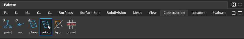

Set Construction Plane
Makes the picked reference plane the construction plane. You can have many reference planes in your scene performing various jobs, but only one plane at a time can be the construction plane.
Access this tool from the Construction tool palette:
