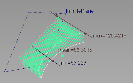

Adds a measurement showing the minimum and maximum deviation between a construction plane and a curve, surface, or mesh. This tool creates a locator showing the deviation between the two objects, labeling the minimum, maximum, and mean.
It also displays a deviation comb indicating the deviation across the length of the objects.

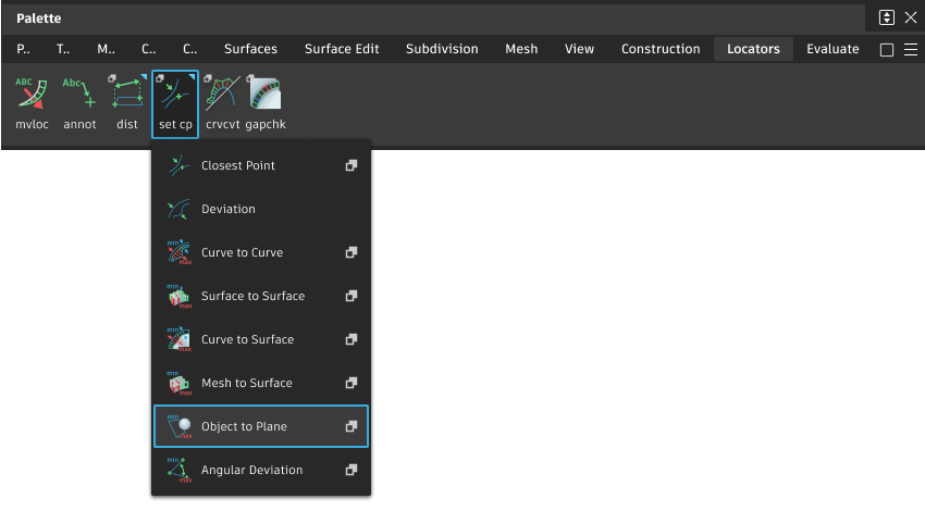

Access this tool from the Locators palette:
