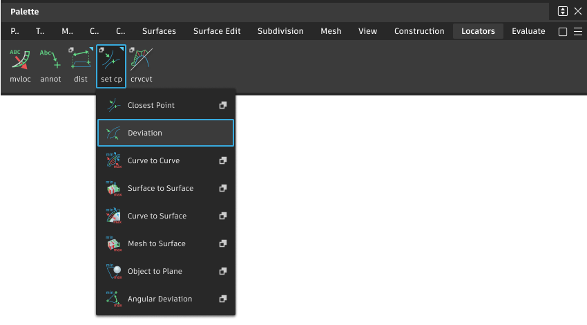

Adds a measurement showing the deviation between two curves.
Access this tool from the Locators palette:
