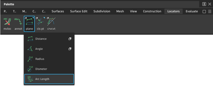

Access this tool from the Locators palette:

  1. Select the Arc Length tool.
