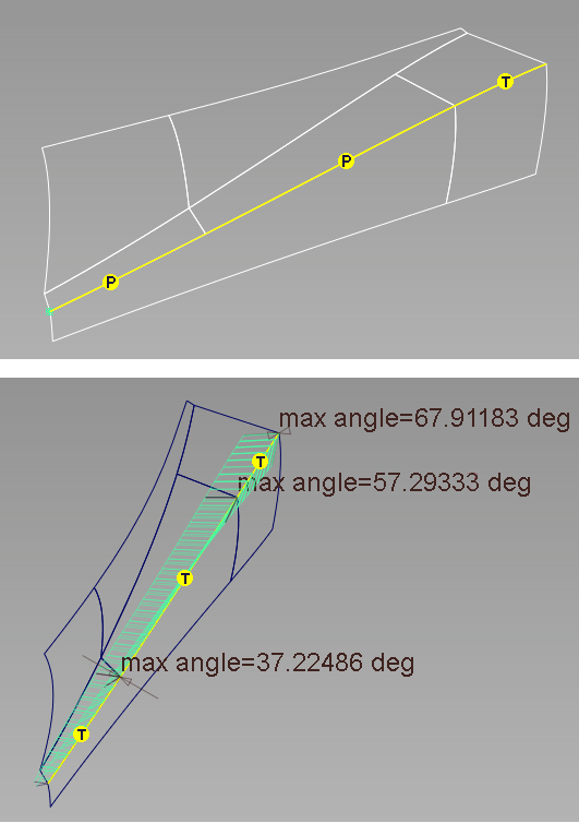

An example
Below are two sets of surfaces. The Surface Continuity tool shows that the longer surface fails to achieve positional continuity with its neighbors (top). The Angular Deviation tool can still be used to check tangent continuity and show angular deviation between those surfaces (bottom).
