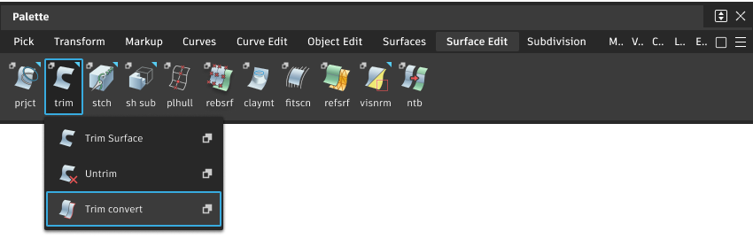

Access this tool from the Surface Edit tool palette:

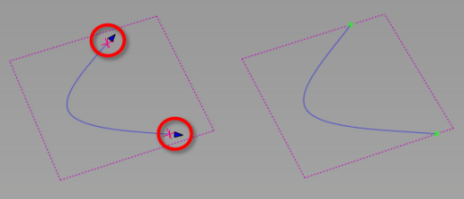

Selected
A trim extend arrow appears on the curve that needs extending. Clicking the arrow snaps the end of the curve to the patch edge.

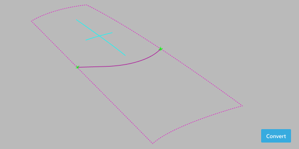

  3. Click on the regions to keep. Make sure that those regions define a four-sided surface.
    Crosshairs appear on the selected regions. (The size of those region selectors can be modified through the option window.)

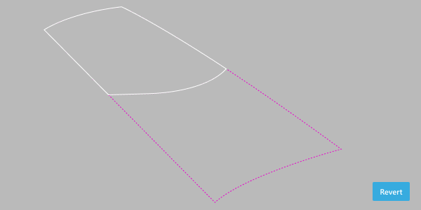

    If Show Surface Deviation is turned on, a locator shows the maximum deviation between the original and the converted surface.
  5. If you are not happy with the result, click the Revert button to get back the original untrimmed surface.

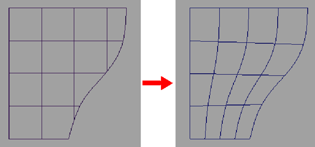

Reshape a NURBS surface so its actual shape resembles its trimmed shape.
  1. Select the Trim Convert tool.
  2. Click a four-sided trimmed surface.
    Note: The Trim convert tool does its best job to match the shape of the trimmed surface with an untrimmed surface. In most cases, an exact match will be impossible.
    Tip: Turn on the Show Edge Deviations and Show Surface Deviations options to attach deviation locators to the resulting surface to see how much the new surface differs from the original.
