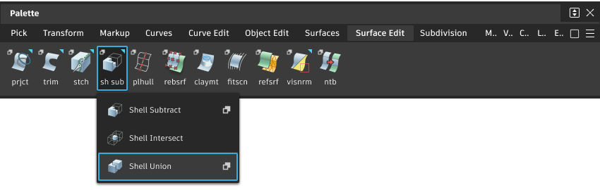

Shell Union
Combines the volumes of two shells into one new shell.
Access this tool from the Surface Edit tool palette :
Shell Union Options
Keep Originals
When selected, template the original shells after the Boolean operation.
Otherwise, delete the original shells.
Shell workflow
  1. Select the tool.
  2. Click the two shells whose volume you want to combine.
