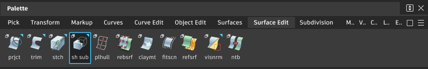

Shell Subtract
Subtracts the volume of one shell from another.
Access this tool from the Surface Edit tool palette:
