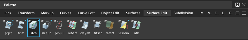

Access this tool from the Surface Edit tool palette:
