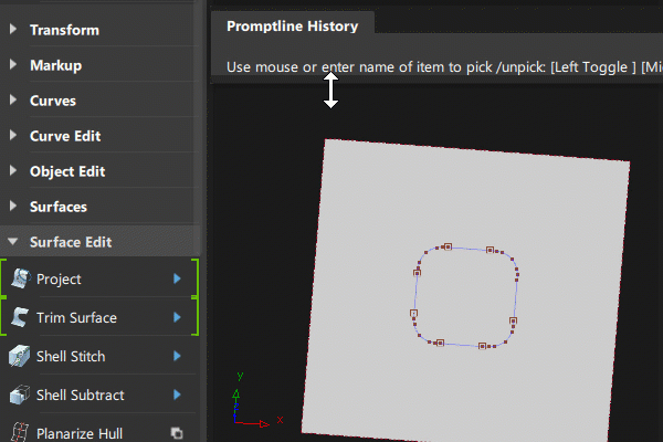

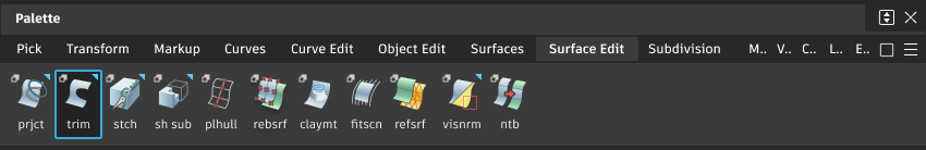

Access this tool from the Surface Edit tool palette:

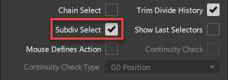

Subdiv Select
Turn this on when trimming the surface of subdivision objects. When on, the Trim tool behaves the same way with subdivision objects as it does with NURBS surfaces. Subdiv Select is on by default.

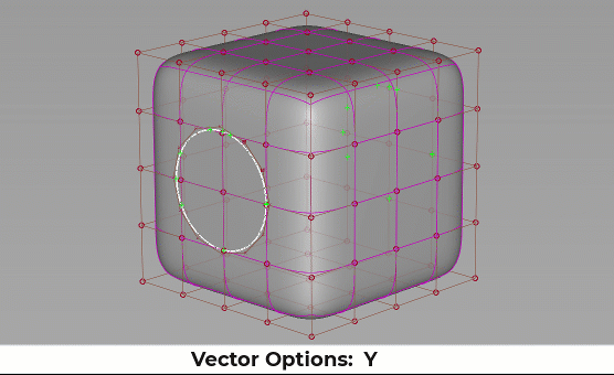

  2. In the control window, turn on 3D Trimming and choose a Vector Option.
    If you select Normal, the curve is projected onto each point on the surface along the normal at that point, instead of along a single vector direction.
    Note: If you are trimming or dividing subdivision surfaces, ensure that Subdiv Select is turned on.

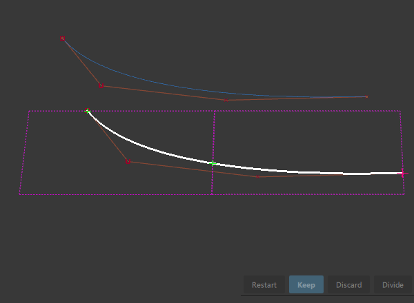

  3. Select all the surfaces you want to trim. Hold down the Shift key to pick more than one surface, or use a pick box.
  4. Select the curves you want to project onto the surface to create trim curves (curves-on-surface). If the desired curves-on-surface are already present, you can skip this step.
    Two surfaces and one curve selected.
    Note: The surfaces and curves can be selected in any order, but the first object selected must be a surface.

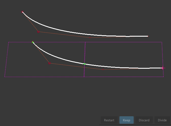

    After selecting the second curve
    As you select surfaces and curves, the curves are automatically projected onto the surfaces, and the corresponding trim curves are displayed on the surfaces. The direction of the projection is determined by the set Vector Option.The default View, which sets the direction of projection based on the view vector of the window where you selected the curves ( that is, perpendicular to the window). To project normal to the surface, you must select the Normal option.

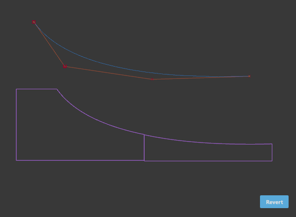

  5. To limit the distance of the projection, turn on Limit Projection. This option is useful when projecting curves onto closed NURBS and subdivision objects. For example, setting a projection distance stops the projection from passing through both walls of the closed object.
    When this option is on, an arrow manipulator appears in the viewport attached to two representations of the projected curve at both ends. Drag the manipulator the set the projection distance based on the current position of the curve. You can also enter values for Positive Distance and Negative Distance.

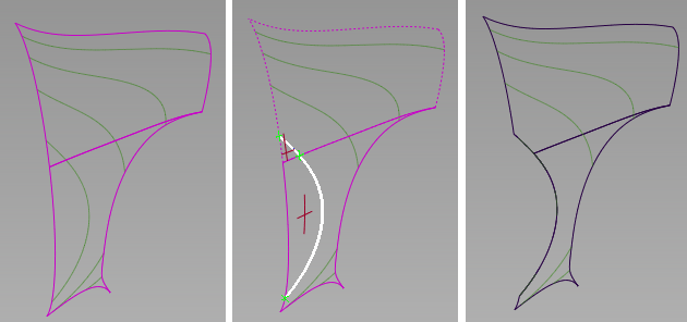

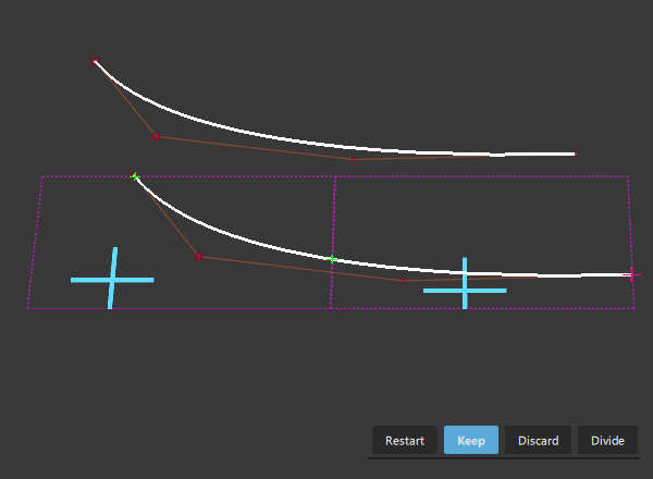

  6. Click on the regions of the surfaces that you either want to keep or discard. (Regions are areas delimited by curves-on-surface). If the trim regions are spread across multiple surfaces, you can box-select them.
    Crosshairs appear on the selected regions. To move a crosshair, click it and drag.
    If those region selectors appear too large or too small on your geometry, you can adjust their size by using the Region Selector U Size and V Size sliders in the control window.
    Tip: You do not have to click a “visible” part of the surface (such as an isoparametric curve). Clicking anywhere inside the surface edges will also work.
  7. At any time, before performing the next step, you can change the vector option in the control window to change the direction of projection.
    The curves-on-surface update.
    Note: If you choose Picked, you must then pick a vector object along which to project.
    Note: If you choose View, you can project different curves along different view vectors. However, if you then click Refresh View Vector, or select a different vector option, all curves-on-surface update to match the current projection vector.
  8. Click one of the buttons: Keep, Discard, or Divide, depending on the type of operation you want to perform.
    Keep: Keeps the regions selected in step 5, and discards the rest.
    Discard: Discards the regions selected in step 5, and keeps the rest.
    Divide: Divides the selected regions from the others (making separate trim surfaces) but keeps all the regions.
    In this example, Keep was used.

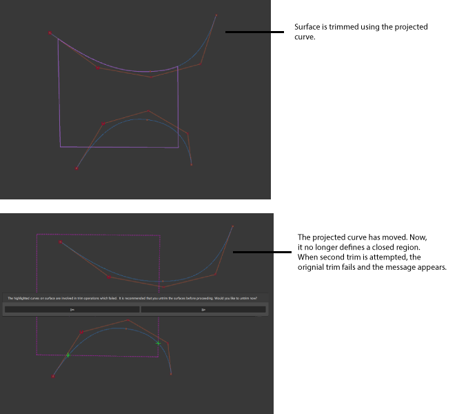

Troubleshoot trimmed surfaces
If you are applying an additional trim operation to a primary surface that has been automatically trimmed when creating a secondary surface, you may see the following alert message:
You may also see this message if you have performed a trim operation on curves created by projecting or intersecting curves or surfaces. The usual cause of the problem is that one of the initial surfaces (or curves) used to create the trim curve or secondary surface has been moved, resulting in a trim curve on one of the initial surfaces that no longer isolates an area that can be trimmed, and this has been diagnosed when you are attempting to create a new trim on the surface.
For example, this diagram shows a fillet created between two flat surfaces. One surface was moved, resulting in an incomplete trim surface. When attempting to create an additional trim on the surface (the circular hole), the problem with the now-incomplete trim curve was discovered.

You can create the bounding curves-on-surface while inside the Trim Surface tool, by projecting curves on the surfaces(s) or you can automatically create a trimming curve-on-surface from the intersection of a surface with the target surface(s).
You can also create curves-on-surface before using the Trim Surface tool.
Cross sections are created using Windows > Cross Section Editor.
