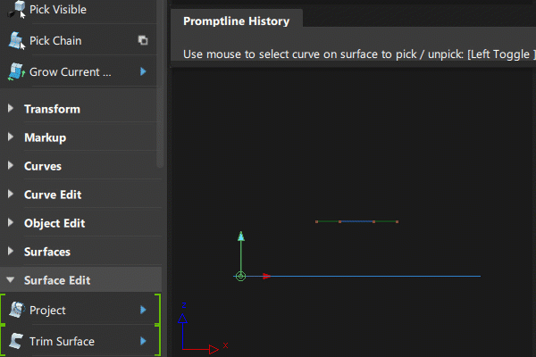

Access this tool from the Surface Edit tool palette:

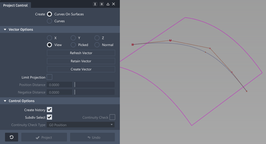

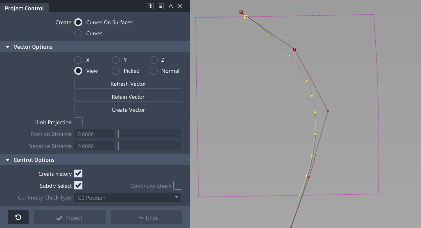

View
Specifies a vector normal to the current view. The vector is not drawn in the view windows.
If the current view is changed, click Refresh View Vector to update the vector.

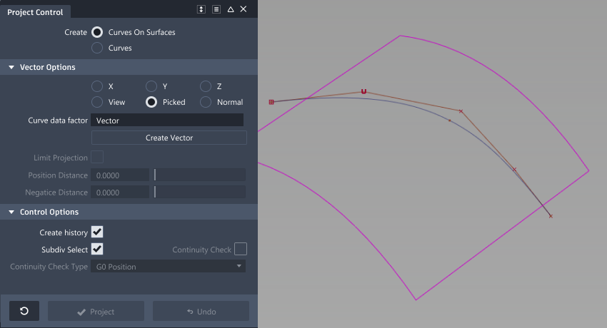

Picked
Lets you specify the name of an existing vector in the Picked Vector field, or pick the vector in the view.

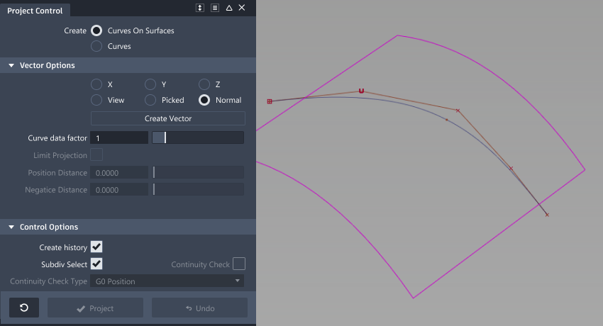

Normal
The projection is done along the surface normals instead of using a single vector direction.
Refresh View Vector
This button only appears if View is selected. Click it to update the vector if the view has been modified

  1. Shift-select the Project tool.
    The control window opens.

  5. Change the view in the Perspective window, then click the Refresh View Vector button. (You can also change the view to that of a different window by clicking in it).
    The curve-on-surface updates according to the new view vector in the Perspective window.
  6. In the control window, choose a different vector option such as X, Y, Z, or Normal.
    The curve-on-surface updates.
  7. In the control window, choose the Picked vector option, then select a vector object.
    The name of the vector appears in the Picked Vector field. The curve-on-surface updates according to the picked projection vector.
