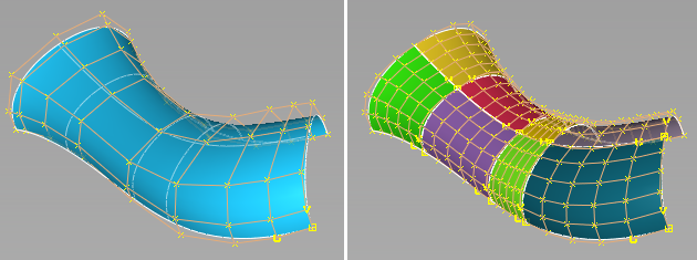

    The selected surfaces are split into several single-span (Bézier) surfaces. The resulting surfaces are not grouped.
    The total number of Bézier surfaces created is posted in the prompt line. The Bézier surfaces have the same U and V degrees as the original surface.
    Degree 5 NURBS surface of 4 x 2 spans split into eight Bézier surfaces.
