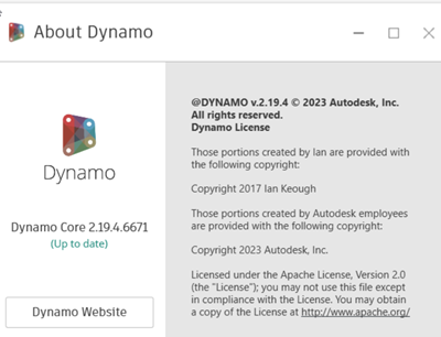

We've updated Alias to Dynamo version 2.19.
For more information about this Dynamo release, see the Dynamo website.
