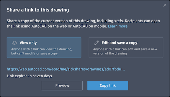

Share a link to a copy of the current drawing to view or edit in AutoCAD on the web or AutoCAD on mobile. The drawing copy includes all external references and images.
Find
Anyone with the link can access the drawing in the a web browser or in the mobile app. The link expires seven days after it's created. You can choose between two permission levels for recipients: View only and Edit and save a copy.
