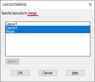

Specify the source layouts to be merged:

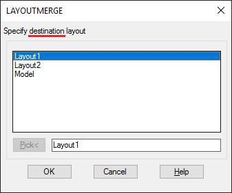

Specify the destination layout into which to merge them, or enter a name for a new layout:

Specify layout(s) to merge or [?]: layout1,layout2 Enter layout names and/or wild cards separated by commas
Specify destination layout or [?] <Model>: Specify an existing layout name or enter a new name to create a new layout
Delete unused layouts? <Y>:
Each merged layout will have a corresponding saved view in the destination layout and will be labeled with a rectangle and text identifier on the DEFPOINTS layer.
