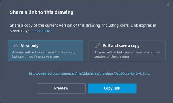

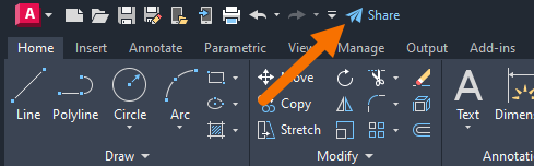

Let's try sharing a drawing from AutoCAD desktop.
The Share dialog box opens.
SHARE packages the file and all its references as a URL that can be opened in the AutoCAD web app. Anyone with the link will be able to open the drawing on the web. The link expires after seven days.

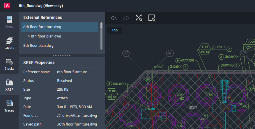

View only drawings are labeled “View-only,” and you’ll notice that the Save, Plot, and drawing tools have been disabled. If the drawing was shared with editing and saving permissions, when the user saves the drawing to a specified location, any references attached to the drawing will be saved to that same location.

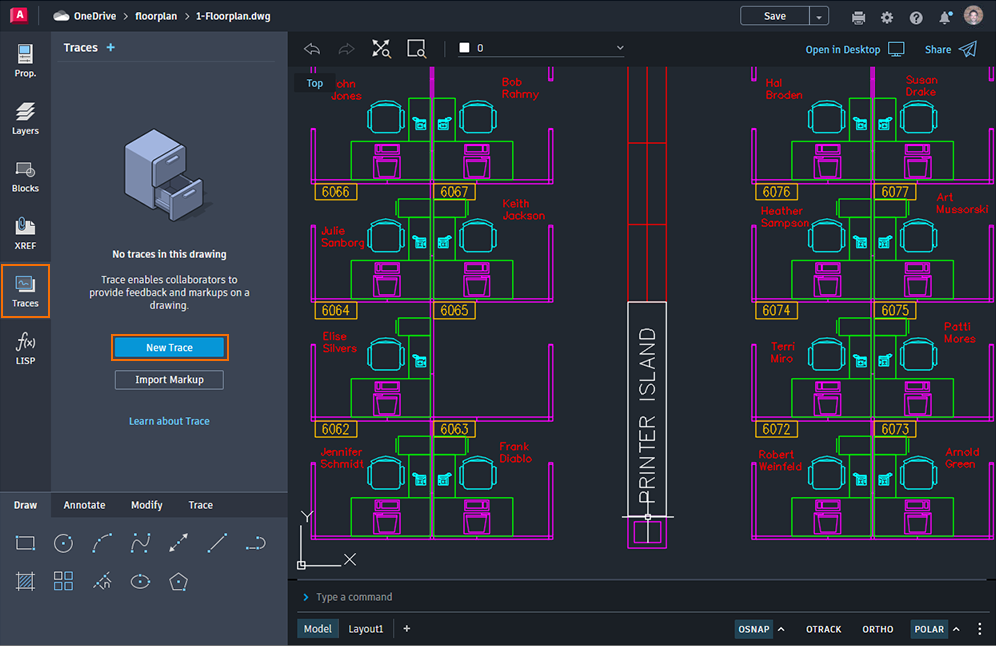

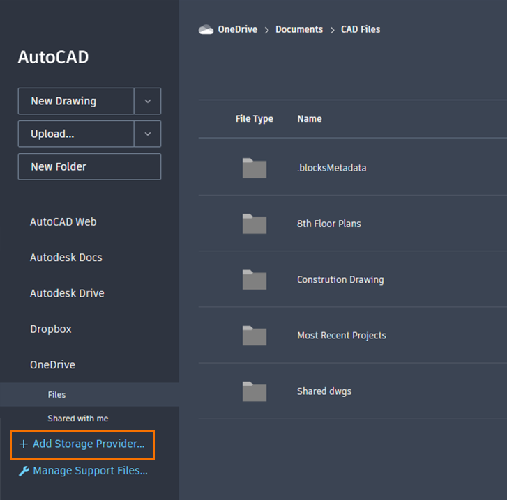

Let’s imagine a scenario where you’re away from your desktop computer, but you realize there are missing details in a drawing. If the drawing is saved to a cloud storage provider, creating a trace on the AutoCAD web or mobile app is a great way to get your suggested changes into the drawing. Let’s try it out. In the following example, we’ll use the AutoCAD web app.
The Trace environment opens.

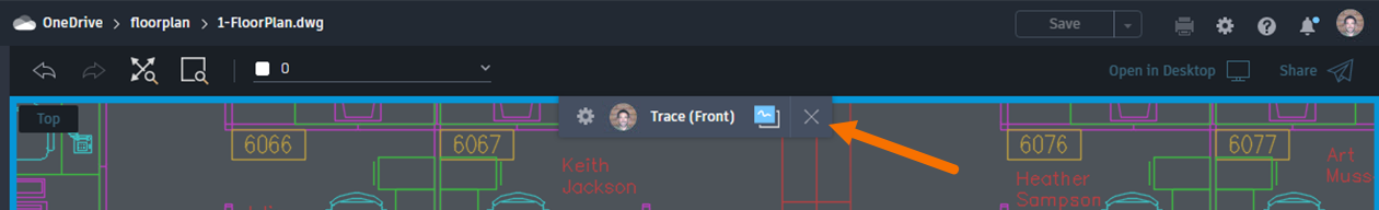

button at the top of the Trace workspace to move the trace to the front of or behind the drawing.
You can also use the TRACEFADECTL system variable to control the opacity of the trace.

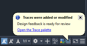

Trace has a slightly different set of features in AutoCAD desktop, web, and mobile. You can view the different functionality below.
| Functionality | Web and Mobile | Desktop |
| View traces from others | X | X |
| Edit drawing while viewing trace | X | X |
| Create a trace | X | |
| Edit, delete, or rename a trace you create | X | |
| Add and remove contributions to a trace created by others | X |
