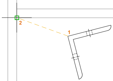

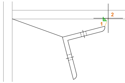

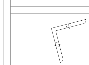

You can move, rotate, and scale selected objects in a single operation based on geometry in a drawing. The following steps move and rotate a "L-shaped" bracket to the intersection of a column and beam.

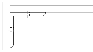

The first and second point pairs move and rotate the selected objects by reference.
This leaves the selected objects unscaled.
If you do want to scale the objects by reference, enter Y and the selected objects will be scaled to match the length between the two destination points.
