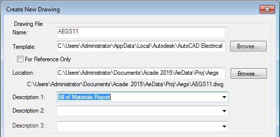

Create a drawing
Description 1: Bill of Materials Report

Add drawings to the project
The Project Manager lists the files under the AEGS folder. New drawings that you add from this point on are added at the end of the drawing order. You now have access to the files required for the exercises in this book.
