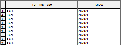

By default, when creating a PLC module the PLC Database File Editor lists as many blank field Terminal Types as there are terminals defined in the New Module dialog box.
You now have a new blank input module with nine terminals and eight addressable I/O points. You now need to define some information for each terminal in the module, the most important being what symbols AutoCAD Electrical toolset should stack together to build the module. Usually the top-most symbol for the module is a little different from the rest so that it can carry some basic information for the module that only needs to occur once in the final symbol.

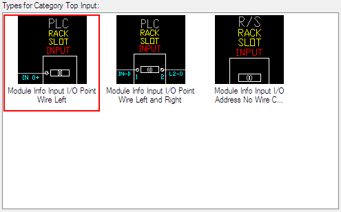

The Select Terminal Information dialog box appears. There are 3 categories for top symbols: Top Input, Top Output, and Top Terminal. Top Input and Top Output are addressable terminals, while the Top Terminal category consists of non-addressable terminals.

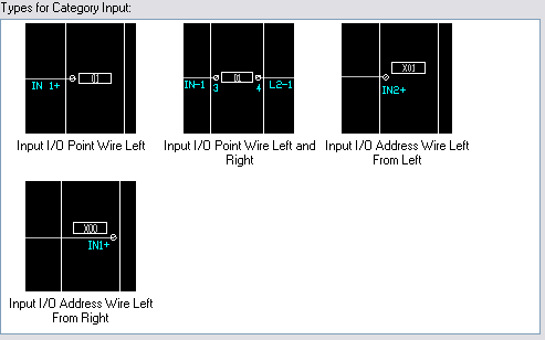

The available terminals for that category appear along with any recently used terminals. Each terminal shown is slightly different. It may have an input wire connection terminal or have terminals for both input and output, or it may not have a wire connection.
The selected terminal is assigned to the Terminal Type in the PLC Database File Editor dialog box. AutoCAD Electrical toolset looks at the block to see what attributes come in when the block is inserted. Some of the attributes come in with predefined values that can be overwritten. You will see these predefined values in the grid below the terminal type list.

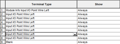

All seven terminals are assigned at the same time.
As an alternative to the Select Terminal Information dialog box, you can use the drop-down list of predetermined Terminal Types. Click the arrow for the Terminal Type and select from the list of available terminal types.
