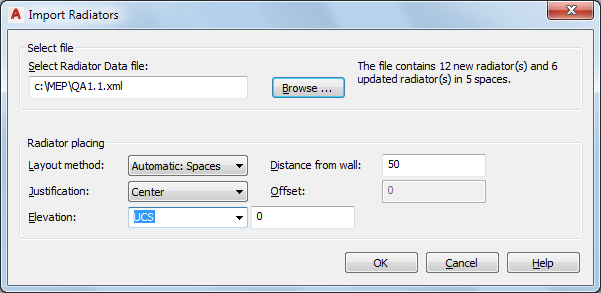

You can add radiators to a drawing using data from an XML file produced by a heating calculation program such as SOLAR COMPUTER Desktop. The XML file contains an identifier for one or more of the spaces in the model. Each space identifier in the file precedes a list of the radiators to be placed into the space.
To add new radiators to a drawing using calculation data
The software places the radiator by applying the positioning options to a window and its wall.
The software adds a radiator beneath each window in the space. It matches the length of the radiators in the list to the width of the windows in the space. If the list contains more radiators than the number of windows currently in the space, the software zooms to that space and prompts you to enter 2 points to place the additional radiators.
The positioning options apply to the line defined by the specified left and right points.
The software zooms to the space being processed. For each radiator in the list, the software prompts you to enter 2 points to position the radiator within the space.
| If you want to... | Then... |
| center each radiator | for Justification, select Center. |
| place each radiator off center | for Justification, select Left or Right, and for Offset, enter a distance. |
| place each radiator a specified distance from a wall | for Distance from wall, enter a value. |
