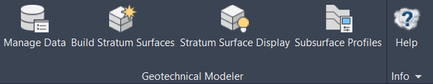

To access the Geotechnical Modeler dialog boxes, do the following:
From the ribbon, select the Geotechnical Modeler tab
Select the appropriate Geotechnical Modeler interface to open:
You can also choose to enter the command prefix GM from the command line as an alternate method to access the Geotechnical Modeler dialog boxes. The following commands are available from the command line to access the Geotechnical Modeler dialog boxes:

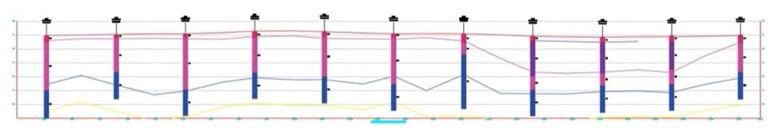

A subsurface profile view represents the different stratum profiles and the boreholes themselves. Select the boreholes you'd like to add to the profile and they're added when the profile view is generated. The profile view can be utilized in the design plan sheets but can also be added in 3D.
