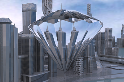

To create a glass diamond like the one above:
- In Action, first make sure you have a background image.
Refraction affects whatever is behind the refracting object, so you need something in the back to see the effect.
- In Action,
right-click the Schematic and select
Import...
- From the import window, select PBS_Diamond and click
Load.
- In the Action schematic,
double-click the Geom node named PBS_Diamond to display its menu.
- In the PBS_Diamond menu, display the
Geometry menu, and set
Sort Box to
Sort Transp.
This ensures the polygons are properly sorted in 3D space, taking transparency into account when z-sorting its polygons.
- Back in the Action schematic, select the Material node named Cube and attached to PBS_Diamond.
- In the Cube menu, display the
Blending menu and set Transparency to 100%.
- In the Refraction section, set
IOR to that of the diamond,
2.418.
You now have a glass cube that refracts its background. Rotate the cube to see its effect on the background.
