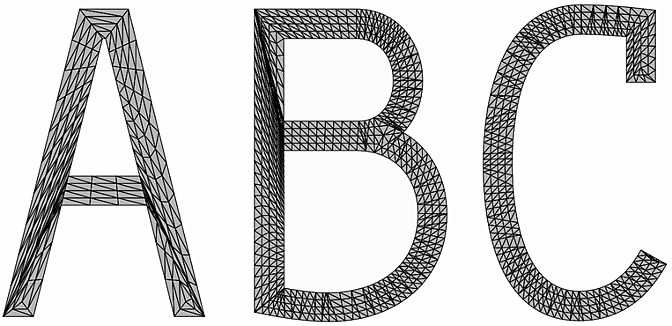

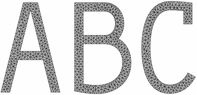

Min Angle field
Displays the smallest value of angle that the polygons can have. If a triangle contains an angle that is smaller than this value, it gets replaced by better-shaped ones. Eliminating small-angled triangles gives a more uniform shading and is more suited for deformations.
Min Angle = 20
Max Area field
Displays the largest value of area that the polygons can have. If a triangle is larger than this value, it gets replaced by smaller ones. This allows the polygon mesh to be deformed more smoothly.
Max Area = 5
Max Vertices field
Displays the total number of new vertices that can be added by the Minimum Angle and Maximum Area options. 0 by default.
Use this option as a precaution against accidentally setting the other options to values that would create huge amounts of geometry with long processing times.
It is not recommended that you rely on this option to control the final number of vertices because it can force the tessellation to stop before the process is completed, thereby giving an unpredictable combination of polygon shapes and sizes.

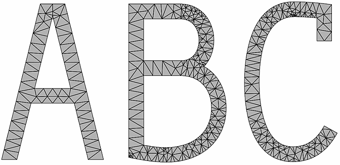

Medial Axis
The Medial Axis tessellation method creates concentric contour lines along the medial axes (averages between the input boundary curves), morphing from one boundary shape to the next. This method creates mainly quads with some triangles, so it is well-suited for subdivision surfaces.
Medial Axis is not available when using the 3D Shape node.
With this method, there are several options for fine-tuning the tessellation further.
Loops field
Displays the number of loops used in the tessellation, modified by the Adaptive toggle.
Loops = 2
Adaptive button
Enable to set the Loops field as the average number of medial axes drawn and to keep the distance between them fairly constant. Disable to set the Loops field as the exact number of medial axes drawn per boundary (rounded to the nearest integer).

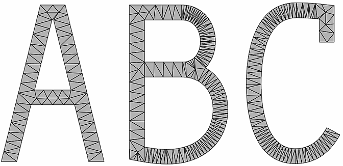

Edge Tessellation box
Select an option to control the shape of the polygons.
Select: To:
None Have long edges that are not split. This results in fewer polygons and lighter geometry, but the resulting long, thin polygons may not deform well.
Equal on Both Sides Have a tessellation made of squarer polygons that deform better, at the cost of a heavier tessellation.
