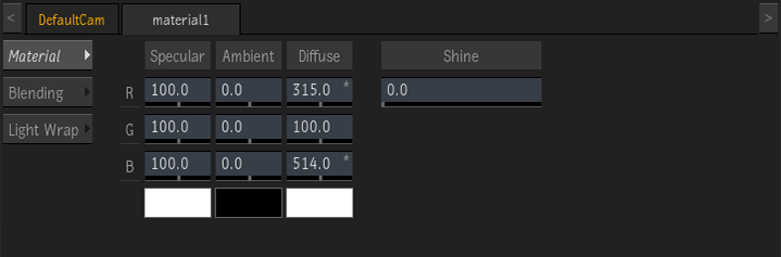

Material Menu Settings
- Red Specular field
- Displays the red specular highlight value. Editable.
- Green Specular field
- Displays the green specular highlight value. Editable.
- Blue Specular field
- Displays the blue specular highlight value. Editable
- Specular colour pot
- Displays the colour of light reflected by the 3D model's surface. To enable the specular highlight, the Shine value must be larger than 0. Editable.
Note: Specular lighting sets the colour of light reflected by the 3D model's surface. To enable the specular highlight, the Shine value must be larger than zero.
- Red Ambient field
- Displays the red ambient colour value. Editable.
- Green Ambient field
- Displays the green ambient colour value. Editable.
- Blue Ambient field
- Displays the blue ambient colour value. Editable.
- Ambient colour pot
- Displays the colour of the area of the 3D model that is not illuminated by a direct light source. Editable.
Note: Ambient lighting sets colour to the area of the 3D model that is not illuminated by a direct light source. The edge of the ambient area mixes with the specular highlight colour and the diffuse colour.
- Red Diffuse field
- Displays the red diffuse colour value. Editable.
- Green Diffuse field
- Displays the green diffuse colour value. Editable.
- Blue Diffuse field
- Displays the blue diffuse colour value. Editable.
- Diffuse colour pot
- Displays the diffuse colour. Editable.
Note: Diffuse lighting modifies the colour and illumination of the entire 3D model. Diffuse light mixes with the colour of the light sources used to illuminate the 3D model. The diffuse colour may also mix with the ambient colour and the colour of the specular highlight.
- Shine field
- Displays the intensity value of the specular highlight. When this value is zero, the specular highlight is disabled. Shine affects both size and intensity. Editable.
See
Creating a Specular Highlight on a Model.

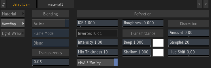

Blending Menu Settings
Blending Settings
- Activate Blending button
- Activating Blending in the material node overrides any blending settings set in the parent node.
- Blend Type box
- Select the type of blending modes available from the Blend Mode box.
- Blend Mode box
- Select how the front and matte clips or the front and back clips are combined.
- Transparency field
- Displays the transparency level of the 3D model. Editable.
Refraction Settings
- Index of Refraction field
- Set the index of refraction of the material. This value is an approximation of real world material refraction. For example, use 1.5 for glass, 1.333 for water.
- Inverted Index of Refraction field
- Calculates the inverted index for refraction value defined in the IOR field. Use this value to recreate the current IOR in an attached substance material. Not editable.
- Intensity field
- Control the intensity of the effect. A high enough value flips the background.
- Minimum Thickness field
- Define the minimal thickness of the object. Use it with a geometry without thickness (a plane) or very thin to ensure refraction, but without altering its actual thickness.
- EWA Filtering button
- Apply filtering to the result of the refraction.
- Roughness field
- Blur out the refraction result. The higher the Roughness, the blurrier the refraction.
- Deep Transmittance field
- Colour the refraction result, with an intensity proportional to the thickness of the geometry. Define the colour using the colour pot.
- Shallow Transmittance field
- Colour the refraction result, with an intensity proportional to the thinness of the geometry. Define the colour using the colour pot.
- Dispersion Amount field
- Control the dispersion of the RGB channels, and is similar to chromatic aberration.
- Dispersion Samples field
- Control the coarseness of the dispersion: the greater the value, the smoother the dispersion.
- Hue Shift field
- Shift the colours.

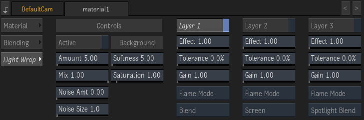

Light Wrap Menu Settings
Controls Settings
- Active button
- Enables the Light Wrap effect.
- Amount field
- Sets the size of the Light Wrap effect.
- Mix field
- Mixes the result of the Light Wrap with that of the source.
- Noise Amount field
- Blends a noise pattern in the region set by the Amount control. This noise creates a non-uniform gradient for the Light Wrap effect.
- Noise Size field
- Sets the size of the noise pattern blended in the Light Wrap region.
- Background Softness field
- Blurs the background pixels, keeping the Light Wrap from looking like a half-transparency effect.
- Background Saturation field
- Affects the colour saturation of the background pixels used by the Light Wrap effect.
Layers Settings
- Layer 1 button
- Tweaks the look of the light wrap using the controls below. The three layers are blended together; Layer 1 blends the Background pixels with the pixels from the object.
- Layer 2button
- Tweaks the look of the light wrap using the controls below. The three layers are blended together; Layer 2 blends the Background pixels with the pixels from Layer 1.
- Layer 3 button
- Tweaks the look of the light wrap using the controls below. The three layers are blended together; Layer 3 blends the Background pixels with the pixels from Layer 2.
- Effect field
- Controls the coverage of the Matte created by the Amount field, growing or reducing the edge of the light wrap matte.
- Tolerance field
- Reduces the light wrap coverage based on the luminance of the pixels of the object: only pixels with a luminance value over the Tolerance threshold are used. Tolerance is a percentage luminance values.
- Gain field
- Sets the intensity of the blending between the layer and the Background.
- Blend Type box
- Selects the type of Blending modes available.
- Blend Mode box
- Sets the type of blending used to blend the Background with the Layer.
