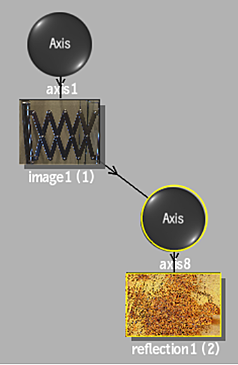

- Double-click the Reflection Map node. You do not need to be in Schematic view to add a node in this manner.
The reflection object is added to the schematic with its own parent axis. The new axis is the child of the selected surface or geometry. In Schematic view, the number in brackets next to the name of the Reflection node indicates the media used for the diffuse.
To specify different media as the source, select the media in the Media menu, then click Apply, or use the Read File tab to manage the texture media (see
Working With Textures in Map Nodes).
