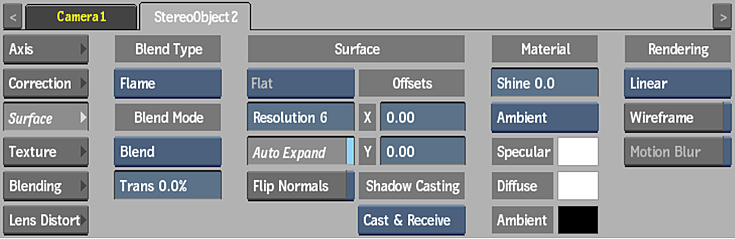

Stereo Object Surface Settings
Use the Surface tab of the Stereo Object menu to adjust surface and shading properties of the stereo object.
The Surface tab settings are the same as in the Object Image menu for non-stereo objects. See
Surface Settings.

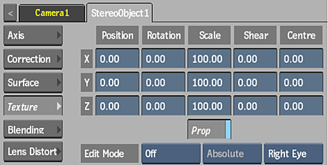

Stereo Object Texture Settings
Use the Texture tab of the Stereo Object menu to set the built-in diffuse maps (as well as any added texture maps) of a stereo object.
- X Position field
- Displays the position of the X axis. Editable.
- Y Position field
- Displays the position of the Y axis. Editable.
- Z Position field
- Displays the position of the Z axis. Editable.
- X Rotation field
- Displays the rotation of the X axis. Editable.
- Y Rotation field
- Displays the rotation of the Y axis. Editable.
- Z Rotation field
- Displays the rotation of the Z axis. Editable.
- X Scale field
- Displays the scale of the X axis. Editable.
- Y Scale field
- Displays the scale of the Y axis. Editable.
- Z Scale field
- Displays the scale of the Z axis. Editable.
- Proportional button
- Enable to change the fields proportionally.
- X Shear field
- Displays the shear of the X axis. Editable.
- Y Shear field
- Displays the shear of the Y axis. Editable.
- Z Shear field
- Displays the shear of the Z axis. Editable.
- X Centre field
- Displays the centre of the X axis. Editable.
- Y Centre field
- Displays the centre of the Y axis. Editable.
- Z Centre field
- Displays the centre of the Z axis. Editable.
- Tools box
- Select whether to sync the left and right eye texture values.
- Sync Type box
- Select whether the relationship between the left and right eye texture values is absolute or relative. Available when Sync L+R is selected in the Tools box.
- Texture Eye box
- Select whether to apply changes to the left or right eye and display the values of the left or right texture.

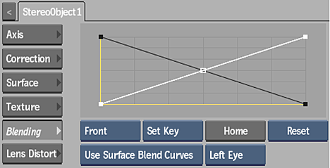

Stereo Object Blending Settings
Use the Blending tab of the Stereo Object menu to adjust the blending curves of each stereo surface separately. The blending curve is similar to the Keyer luminance blending curve, but you can adjust it per eye.
You can switch between the stereo surface blend curves and the keyer blend curves. This gives you a good comparison to luminance curve work you have already done in the Keyer.
The Blending tab settings are the same as in the Object Image menu for non-stereo objects. See
Applying Blending Curves per Surface. One extra setting is available for stereo objects, allowing you to select which eye to apply blending curves.
- Eye Selection box
- Select which eye to apply the blending curves. Select Both Eyes to apply the same blending settings to both eyes. In this case, the settings of the last selected eye apply to both eyes.

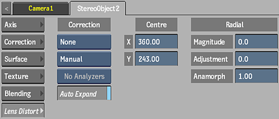

Stereo Object Lens Distort Settings
Differences in camera lenses or perspective irregularities cause lens distortion that results in skewed angles. Use the settings in the Lens Distort tab to rectify or simulate these types of distortions in your stereo images.
The Lens Distort tab settings are the same as in the Object Image menu for non-stereo objects. See
Lens Distort Settings.
