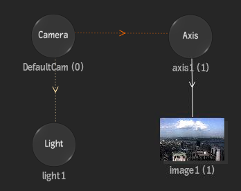

- In the schematic, drag from an object with axis characteristics to another object with axis characteristics.
The selected objects are connected by an orange dotted line with an arrow.
As you move away from that frame, notice that the connection line is dimmed, signifying that you can then add another connection from the same parent to a different node at another frame.
- To delete a look-at link, make sure that Look At is selected in the Tools box, and return to the frame where the link is active (orange dotted line), then swipe through the line.
