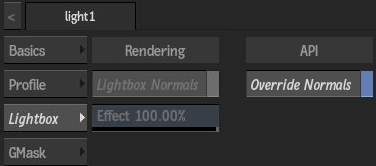

Lightbox Tab
Use these settings when a Lightbox node is attached to a Light.
- Lightbox Normals button
- Enable to take normals into consideration to compute the transparency of the Lightbox effect on the scene.
- Effect field
- Displays how much the orientation of the normals affects the result of the shader, relative to the light position in the scene. Available when Lightbox Normals is enabled. Editable.
- Override Normals button
- Enable to force all surfaces to be affected by the Lightbox shader, when Light Normal attenuation isn't appropriate for the Lightbox effect. Disable to only affect front-facing surfaces, relative to the light. The default behaviour of this button can be set as an XML tag in the shader.
