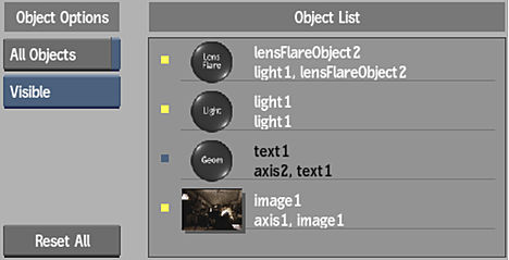

You can select objects to include in your output by using the Object Options and Object List, or the Edit Output mode. Objects that are part of an output are displayed in the Object List. For each selected object, you can decide if you want it to be visible in the final render or not. Non-renderable objects, such as cameras, are always included in outputs.
Tip: When you create a new output in the Outputs list, it is empty by default. Enable All Objects to display all objects in the scene.

To output all objects:
- In the Object Options, enable All Objects.
All objects in the scene, as well as any object you subsequently create, are included in the selected output.

Object Options
- All Objects button
- Enable to output all objects in the Object List.
- Visibility box
- Select a visibility option for the selected object.
- Reset All button
- Click to set all objects to Visible mode in the Object List.
