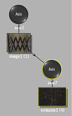

- In the schematic, select the surface or 3D geometry to which you want to apply the emissive.

- Drag the Emissive Map node from the node bin and place it in the schematic.

The emissive object is added to the schematic with its own parent axis. The new axis is the child of the selected surface or geometry. In Schematic view, the number in brackets next to the name of the Emissive node indicates the media used for the emission.
