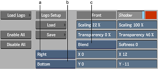

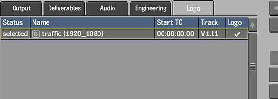

The logo controls are found in the VTR Output module, under the Logo tab.
Note: When you select the Logo tab, you see the clip selected in the Output list instead of the VTR feedback.

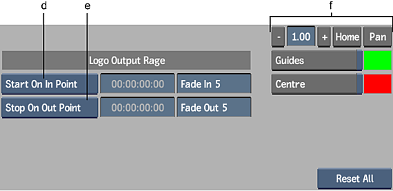

(a) Horizontal alignment button (b) Vertical alignment button (c) Blend Mode box
(d) In point (e) Out point (f) Zoom controls
- Logo
- Enables or disables burning of the selected logo on output.
- Load Logo
- Opens the Clip Select menu where you can select logo clips.
- Enable All
- Use to display the logo on all clips to output.
- Disable All
- Use to remove the logo from all clips to output.
- Scaling (Front)
- Changes the size of the Logo clip. The range of values is 0 to 100, with 100 being the actual size of the Logo clip.
- Transparency (Front)
- Changes the transparency of the Logo (front clip). 0% is Opaque. 100% is Transparent.
- Position controls (X and Y fields)
- Moves the logo along the X and Y axes.
- Blend Mode box
- Selects how the front and matte clips or the front and back clips are combined.

- Shadow
- Uses the Matte clip to add a Shadow. The default position is set to X:-5 and Y:-5. A colour pot on the right allows for the shadow colour to be changed.
- Scaling (Shadow)
- Changes the size of the shadow. The range of values is 0 to 100, with 100 being the actual size of the shadow.
- Transparency (Shadow)
- Changes the transparency of the Shadow. 0% is Opaque. 100% is Transparent.
- Softness
- Softness can be added to the Shadow. The range of values is 0 to 200.
- Horizontal alignment
- Positions the logo along the X-axis using one of the following options.
| Select:
To:
| Horizontal Centre
Center the logo on the X-axis.
| Left
Snap the left edge of the clip to the Safe Title guide on the left.
| Right
Snap the right edge of the clip to the Safe Title guide on the right.
- Vertical alignment
- Positions the logo along the Y-axis using one of the following options.
| Select:
To:
| Vertical Centre
Center the logo on the Y-axis.
| Top
Snap the top edge of the logo to the Safe Title guide at the top.
| Bottom
Snap the bottom edge of the clip to the Safe Title guide at the bottom.
- Guides
- Enables the display of the Safe Action and Safe Title guides within the Clip Preview window. Use the colour pot to change the colour of the guides.
- Centre
- Enables the display of the Centre guide within the Clip Preview window. Use the colour pot to change the colour of the Centre guide.
- In point
- Select an option to specify when the logo appears on the clip.
| Select:
To:
| Start On In Point
Have the logo appear at the in point of the clip.
| Start After Frames
Specify after how many frames the logo appears. Enter the number of frames in the adjacent field.
- Out point
- Select an option to specify when the logo disappears from the clip.
| Select:
To:
| Stop on Out Point
Have the logo disappear at the out point of the clip.
| Duration
Specify how long the logo remains on screen. Enter the duration in the adjacent field.
| Stop Before Frames
Hide the logo before the end of the clip, by the number of frames specified in the adjacent field. For example, selecting this option and entering a value of 5 makes the logo disappear by frame 15 in a 20-frame clip.
- Fade In
- Defines the length of the logo fade in. A value of 0 indicates there is no fade in.
- Fade Out
- Defines the length of the logo fade out. A value of 0 indicates there is no fade out.
- Zoom controls
- The small VTR Output module is not available from the Logo tab. Use the Zoom controls to view oversized clips.
- Reset All
- Use to reset the Logo controls to default.
