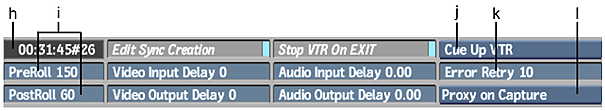

(a) Device Name box  (b) Video I/O Timing box  (c) Precision box  (d) Timecode Source box  (e) Input and Output Connection boxes  (f) Colour Space box  (g) Output Sync box   (h) VTR Current Timecode field  (i) PreRoll/PostRoll fields  (j) Cue Up box  (k) Error Retry field  (l) Proxy Box

PreRoll field
Indicates the pre-roll, in frames.
PostRoll field
Indicates the post-roll, in frames.
Video Input Delay field
Indicates the video delay on input, in frames. If this value is incorrect, the result clip when you click Frame Grab in the VTR Input module does not match the frame you see in the preview window.
Video Output Delay field
Indicates the video delay on output, in frames. If this value is incorrect, the clip you output does not get recorded to the proper place on the tape.
Audio Input Delay field
Audio Output Delay field

Cue Up box
Determines the speed of the cueing process.
Select: To cue up the VTR:
Cue Up VTR Using the internal cueing algorithm of the VTR.
Cue Up Fast Forward Using Flame. Use this option if Cue Up VTR is too slow for far cue points, such as on the betacam SP.
Error Retry field
Indicates the number of times Flame retries failed input or output processes.

Proxy box
Determines proxy management when inputting clips.
Select: To generate:
Proxy in Post Proxies as a post-processing step
Proxy on Capture Proxies during capture
Generating proxy during capture is the quickest method. Depending on hardware configuration of your system, capture may be performed in real time with playback. Some extra required processing, however, may prevent the graphics board from updating the image window and broadcast monitor in real time, so you may not be able to view the clip being played as it is captured.
