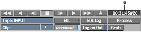

The current frame on the cassette in the VTR appears in the image window and the Current Timecode field (the uppermost timecode field in the Clip Input and Output menus) displays the timecode of the current frame.
(a) Current Timecode field  
Use the following VTR Transport controls to play the VTR.
Note: The VTR must be in Remote mode to use the VTR Transport controls.
Click: To: Hotkey:
Rewind the tape. Home
Play the tape backward. -
Move backward one frame. Hold down to slowly jog backward. left arrow key (down arrow key for -5 frames)
Stop the tape. spacebar
Move forward one frame. Hold down to slowly jog forward. right arrow key (up arrow key for +5 frames)
Play the tape forward. Enter
Fast-forward the tape. End
Eject the tape. none
