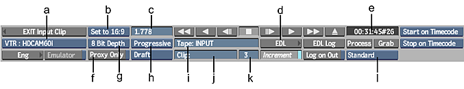

The basic VTR Input controls are described as follows.
(a) Device Name box (b) Aspect Ratio box (c) Aspect Ratio field (d) EDL button (e) Current Timecode field (f) Proxy Quality box (g) Bit Depth box (h) Scan mode box (i) Tape Name field (j) Clip Name field (k) Increment Name field
(l) Tape Type box
- Device Name box
- Select the VTR and timing combination to use to csteapture clips. The available VTR are defined in the software configuration file using the VTR keyword. The available VTR are defined in the Smoke Setup application.
- Engineering button
- Opens the engineering menu.
- Aspect Ratio box
- Select the aspect ratio of the clip to capture.
- Aspect Ratio field
- Displays the aspect ratio of the clip to capture. Editable.
- Bit Depth box
- Select the bit depth used to capture the clip.
- Scan Mode box
- Selects how to flag the captured clip: Progressive, Field 1 dominant, or Field 2 dominant. The flag is only there as a reminder; for example, setting Field 2 does not prevent you from de-interlacing on Field 1. In most cases, select the option that matches the format you are capturing.
- Proxy Only button
- Enable to capture proxies only. In this case, the high-resolution media is captured, proxies are generated, but the high-resolution media is discarded. As a result, much storage space is required.
Only available if the current project is configured to use proxies. If your proxies are set to be generated as a post process in the Engineering menu, you can see an estimated time required for proxies generation in the message bar. You can abort this process at any time by clicking anywhere on the screen. When you click the screen, a message appears asking you to confirm the operation. Only the captured media that corresponds to completed proxy generation is preserved. Any captured frames for which no proxies have been generated are purged.
- Proxy Quality box
- Proxies generated during capture are always of draft quality. Using the Proxy Quality box, you can set the default quality for proxy generation after capture. Results vary depending on the type of clips involved, so it is a good idea to try different settings.

- Tape Name field
- Displays the name of the tape from which you are capturing. This name is important for EDL assembly and media recapture procedures. Editable.
- Clip Name field
- Displays the name to use for the clip to capture. Editable.
- Increment field
- Displays the number automatically appended to the clip name. Active when Increment is enabled.
- Increment button
- Enable to append numerical increments to the clip name automatically.
For example, enter “My_Clip” in the Clip Name field and then enable Increment Name. The first clip you capture is named “My_Clip-1”, the second is named “My_Clip-2”, and so on.
