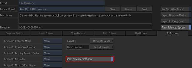

Keep Timeline FX Renders.When exporting content with Timeline FX as a Background task, the export renders every non-rendered Timeline FX. Once the export completes, the renders are usually flushed.
You can now keep these rendered frames by selecting, in the Media Export window, .
