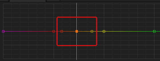

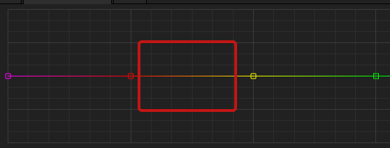

To work on a specific colour, use the Plot button.
To plot a colour:
In addition to the plotted colour, two points are added to the curve, one on each side of the plotted colour. These points isolate the plotted colour, helping you edit only the colour you selected.
| Before plotting the colour | Plotted Colour with isolation points |
| Colour picker with zoom | Colour being picked displayed on the curve |

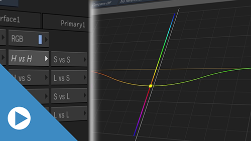

You can display a vertical colour preview in the three Hue vs. curves. It appears when you move gesturally a point, and it gives you preview of the outcome.
