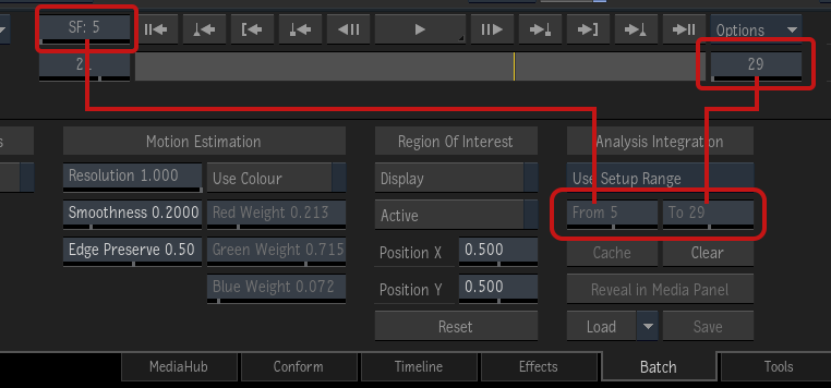

Automatic Duration for Analysis IntegrationYou now have two options to set the range of the Motion Vectors, Normals Maps, and Z-Depth Map Analysis Integration.
In Batch: With Use Setup Range, From and To match Start Frame (SF) and End Frame.
