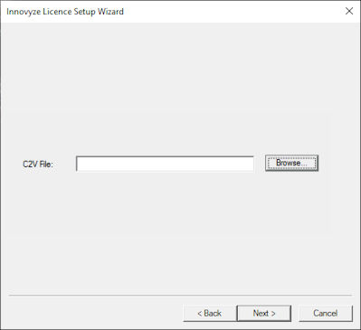

The Create Status File Page of the Licence Wizard is used to create a .c2v status file to send to Innovyze.
Licence Setup Wizard - Create Status File page
Enter a filename or click on the Browse button to browse for a location to save the file to in a Windows Save As Dialog.
Click Next to save the file. The saved file will contain information about the contents of the dongle which will allow Innovyze to produce and send a new .v2c dongle upgrade file.
